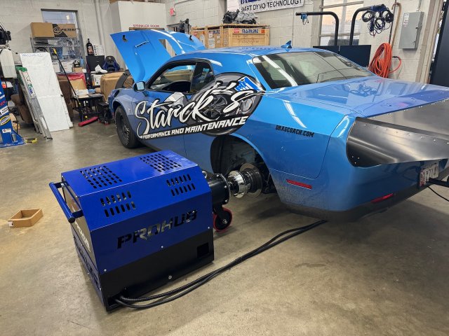

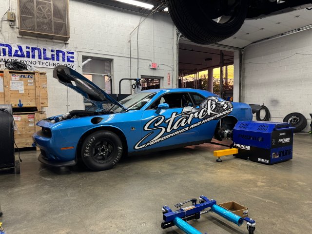

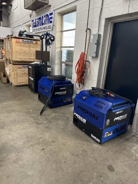

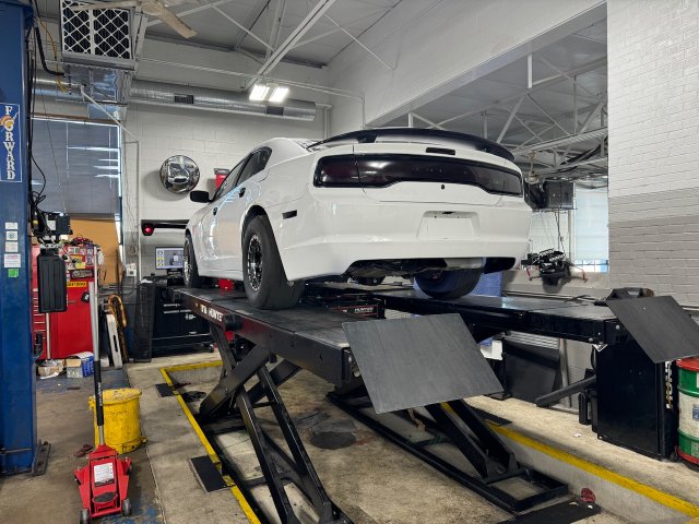

Its been a thrash the last 24 hours. This car was used to mock up in the shop. Hellcat will be the first car to make a power pass then Mikes. Then whatever after.

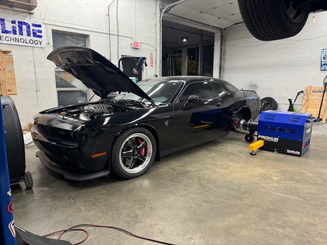

Stay tuned, might live stream the Hellcat on the dyno.
4,126
10,377
Thread Starter #629
she made some good power north of 900 easily.
hp:nunya tq:bidness
the important part of the night was learning the dyno software. No tuning, no logging.

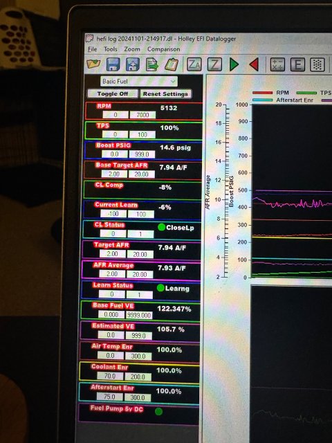

kinda stretched at all ends, hellcat was a treat to make a passes on the dyno.
race car not so much, non lockup convertor makes it hard to load it up for the ramp, progress is being made, 14psi of boost, safe 12* of timing. Ill let the holley data speak for itself

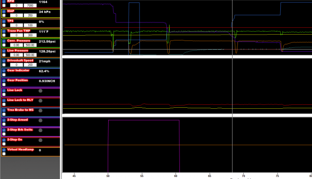

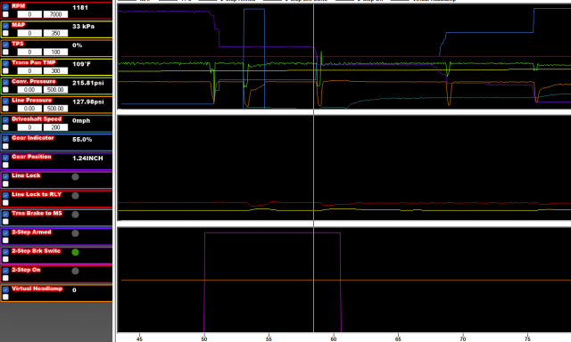

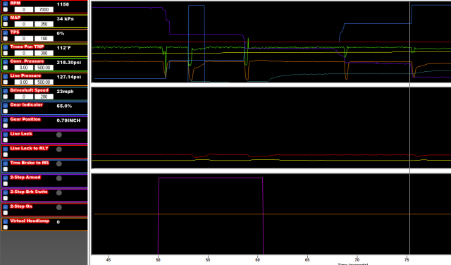

IF ANYONE IS USING A TH400 READ THIS POST....
Abso-fcking-lutely disregard what you think you know. @zhc and @Marc W are saints with their patience and outright not calling me a fuck tard so for that I am thankful. I was having an absolute nightmare getting the TH400 to go into gears. Well this is the second time Motion Raceworks products have bit me in the ass, the first was their stupid ass sensor block for TH400 cars (fuck that thing it's a pile of shit, the only reason it's still in the car is because I don't have the funds to switch to low-doller motorsports). So the Operator Shifter was adjusted and setup just like in their youtube video. Well it's wrong and I'm telling anyone here now, stick with B&M ratchet pro shifters. To get mine to work I had to work backwards from clean neutral to get third to engage, it's hilariously fickle how a TH400 gets bumped into gear.
Vertical cursor is right before I shifted from R/N to 1.
vertical cursor is right before I shifted from 1 to 2
vertical line is before I went to 2 to 3.
The orange line dips are convertor pressure dropping which is expected as I was not on the gas. It took us a few hours to get it right by then I didn't even want to do a full throttle pull, I was so sick and tired of this shit. It will honestly be a miracle if I get to run Saturday, when doing a prior WOT pull we blew out an oring on the trans cooler so now I need to get that fixed but to be honest the derale cooler is shit and I wish I went with a different brand.
