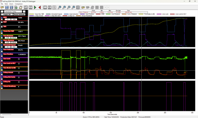

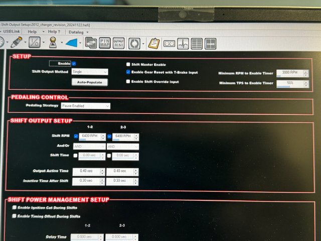

Holley has a new transmission ICF I am learning to tune.

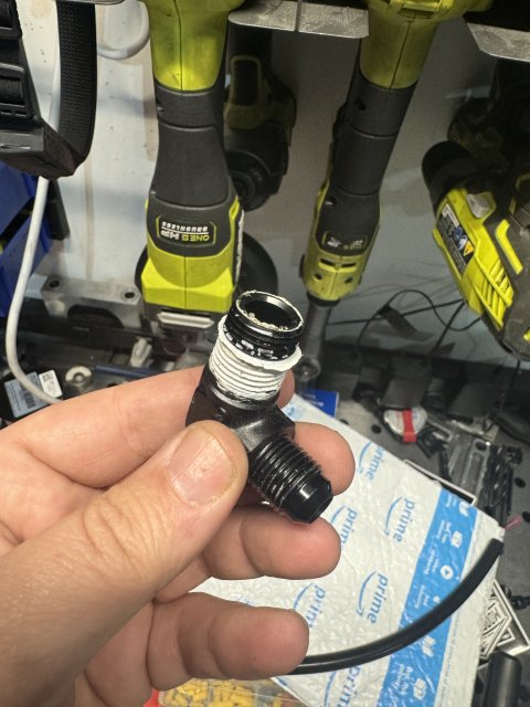

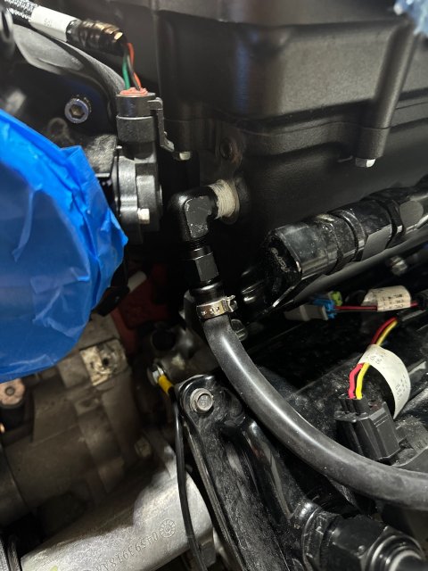

Thread Starter #654
Think we found the boost leak. Lets just say my brake booster is probably feeling some way…
pulling vacuum from here
well thats a runner post rotors will all the spicyness and its going to my poor brake booster. Would explain why the brake reservoir cap is always seeping… im going to pull vacuum from here…
just waiting on some an orb fittings
8,731
7,666
Brakes must have been tight 😆 yeah, pull from the intake track on the snout if possible. my 4.5 whipple had me take the vacuum from the back of that hideous rear intake elbow pre rotor

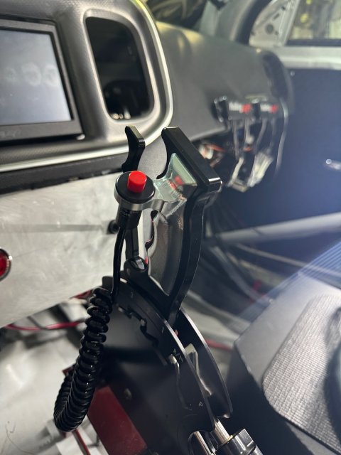

Thread Starter #656

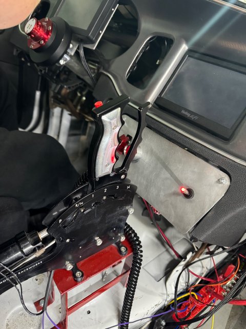

added some bling, also have decided that since I have co2 i will be using the transbrake as well, will be testing on the dyno soon.

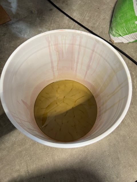

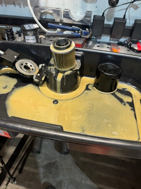

First oil change.
No I don’t have a headgasket leak. E85 contamination. Catch can was bone dry. Might need to change that.

Wow what caused that?
4,126
10,377
Thread Starter #659
Many factors such as worn rings or potentially too long of a line for the can
7,526
19,756
Isn't the motor new or am I lost in the thread somehow? I'd suspect too much injector or something.
