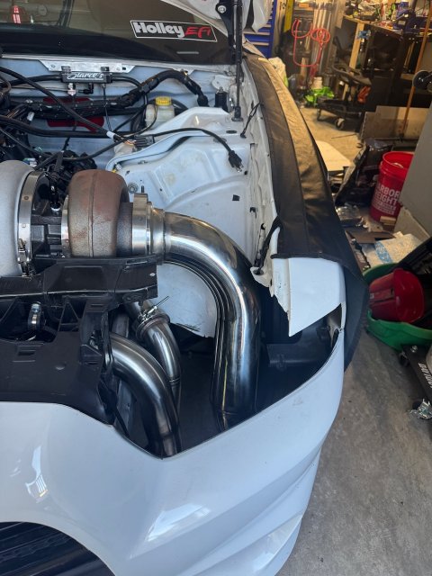

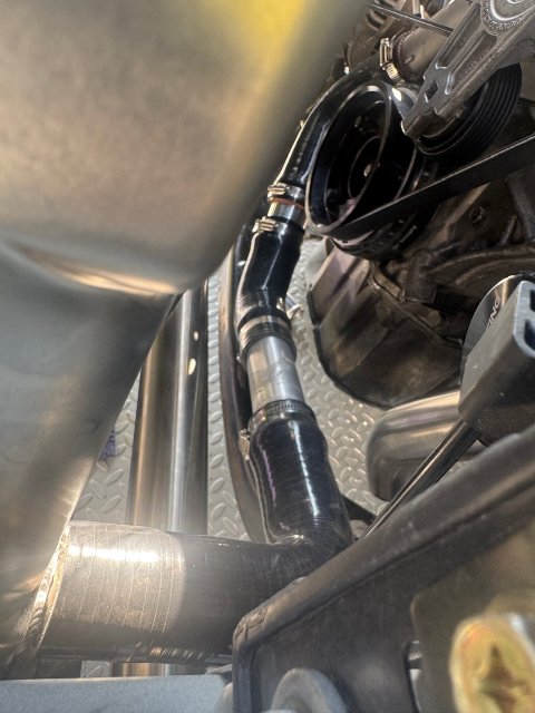

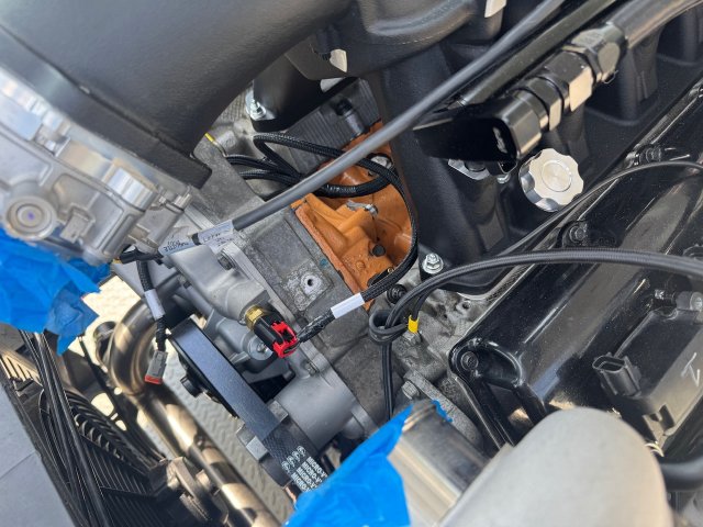

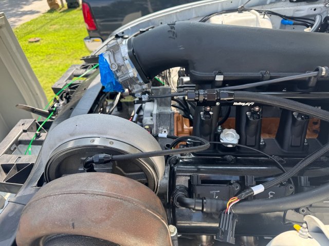

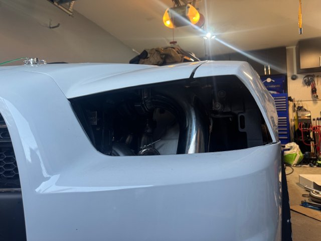

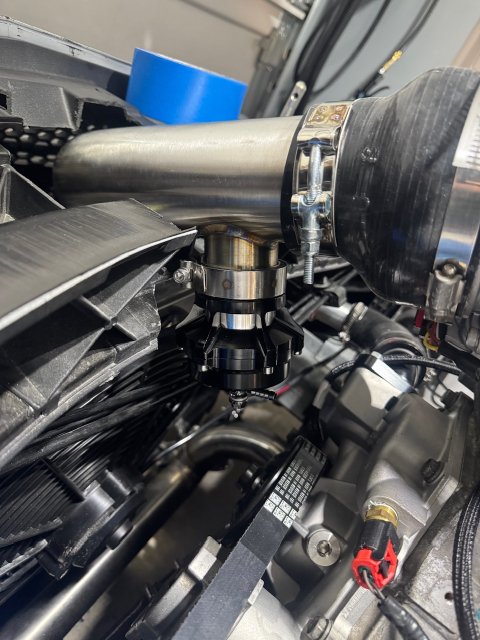

Good progress starting to look like an engine bay coolant system and oil systems are sealed. Waiting on new map sensor and a dome sensor. Then I can plumb the turbos, write a config to Holley and get ‘r done.

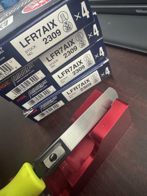

Because my friend Jon hasn’t texted me a better plug. 😭

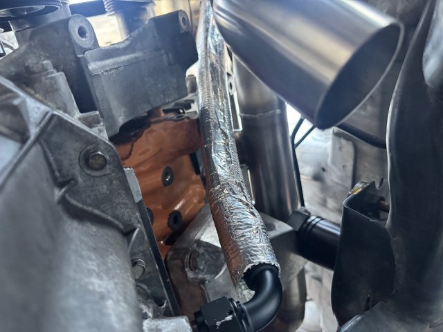

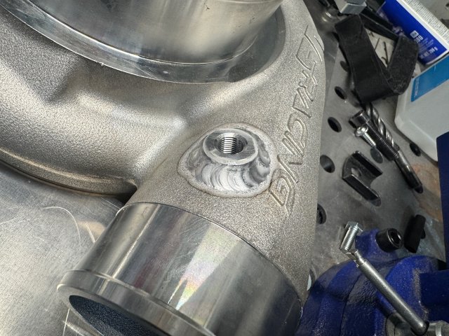

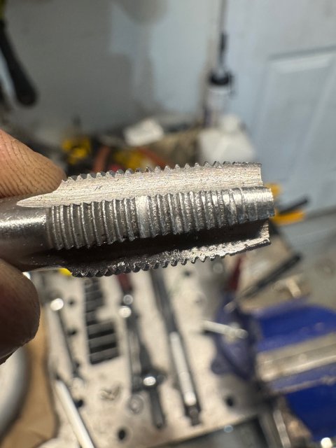

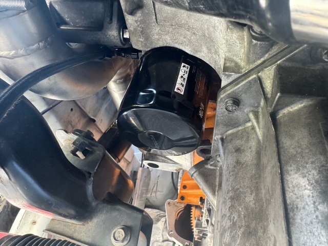

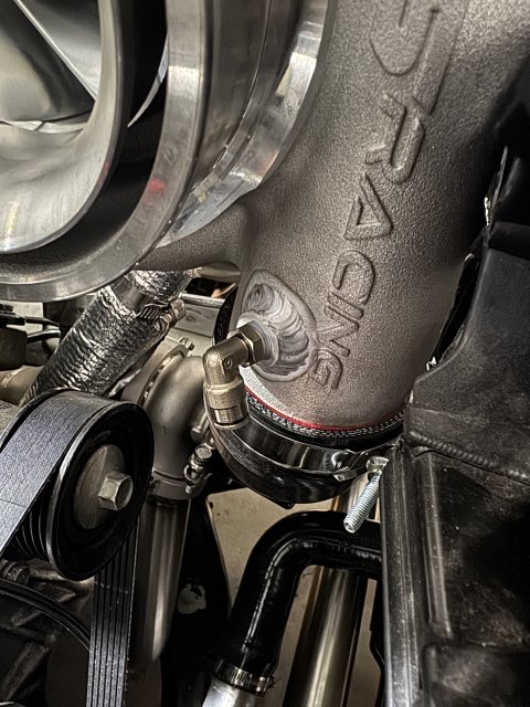

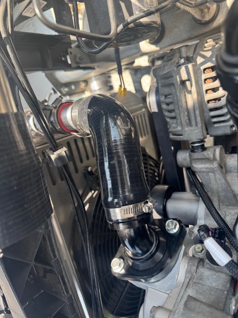

The things they never mention in the instruction manuals. Man building a turbo car does have a learning curve 🤣😭

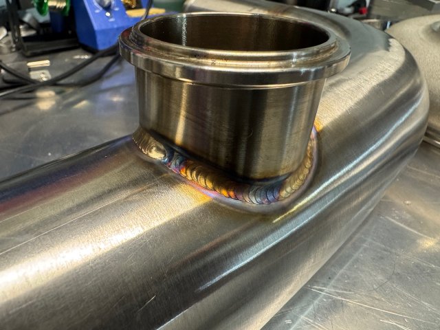

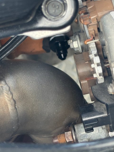

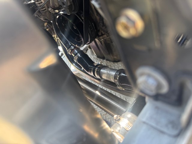

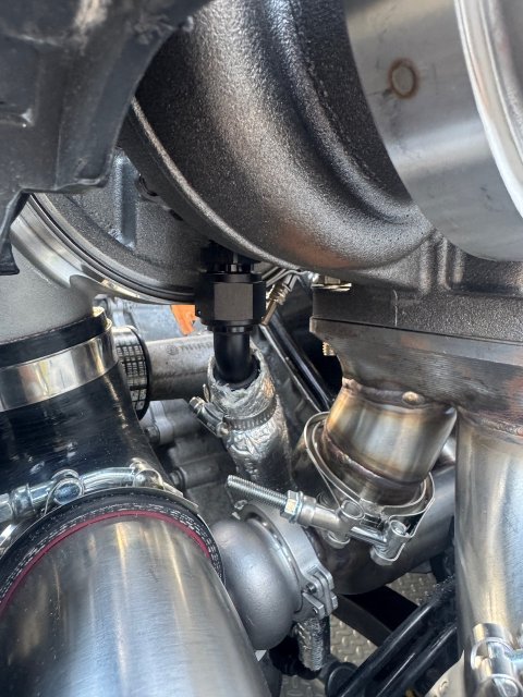

Nice looking welds. I remember your learning thread.
Oh hell no, took these to a real welder. I bungled the npt threads cause god hates me, npt tap galled up and well infinite spins

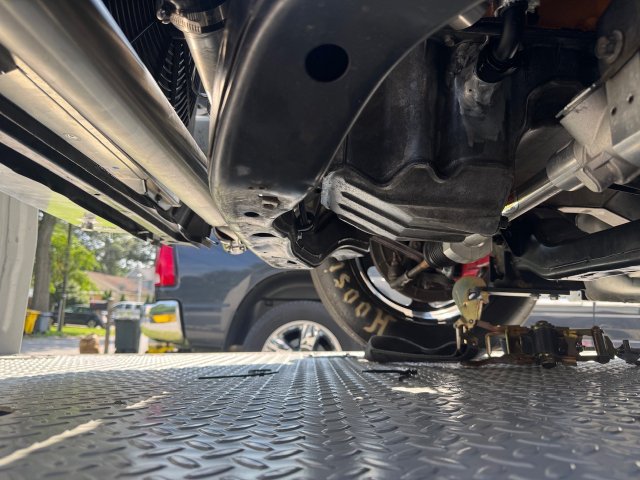

Shin destroyer 9000

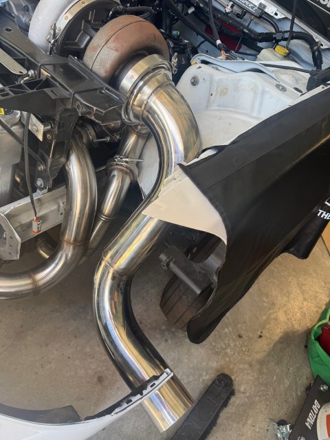

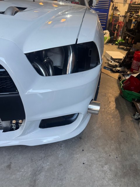

its going to get a vband so I dont have to take the exhaust off to take the bumper off.
