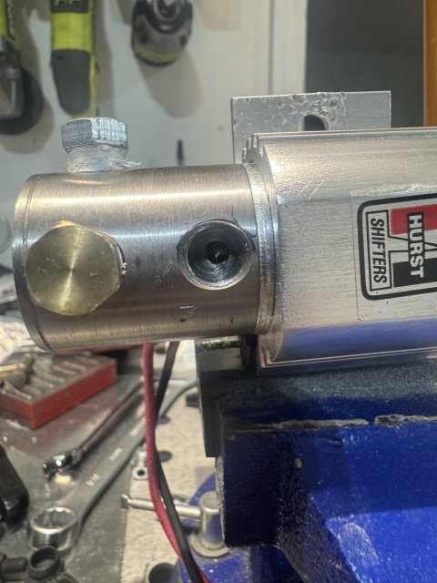

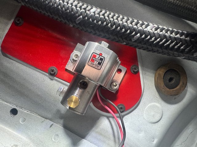

Im losing my fucking sanity, cant get this shit to seal.
sure enough the fucking hemi line lock is not inverted flare…
starting to lose my sanity and mental health

Is that teflon tape?
I use Loctite 567 for anything that's going to have pressure or fluids behind it. (Nitrous, oil, brake, etc.) The only time I use Teflon tape is on my wife's gardening equipment.

Though I see that’s not what you’re struggling with since a flare fitting should seal without any sealant.

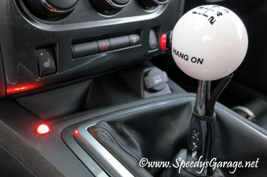

Weird, I had one of those LL in my 2009 Challenger M6 for years and never had a problem with it. Maybe I'm lucky. I put a custom LL button on the shift ball and text that said "hang on" :LOL:
Red illuminated button in front of the shift bezel was the activation switch as a safety measure. Flip that on and it enabled the button on the shifter.

Pulled the threads on the line lock. Im done. Burnouts will be done old school way.

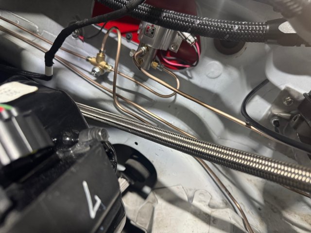

No leaks first try, also improvised parking brake.
