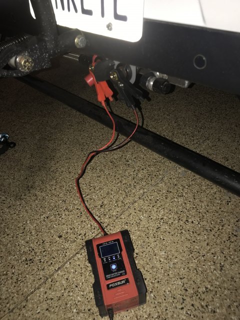

Well crap. Weather's been crap and I've not driven GoManGo in about 6 weeks. Went out to the garage to check it and the Arc Angel battery seems to have lost enough charge that it won't power the car. DMM says 11.38V. I don't think you can jump a L-ION battery.
What do I need, a trickle charger for L-ION to get it back up to snuff?

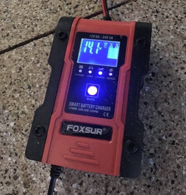

Fooling with the RC cars I learned you have to be careful with the LiON stuff. If they catch fire things get interesting real quick. I was spooked to try to jump start as I'd read reports of that frying the LiON batts.
I ended up getting the NOCO 5 charger. Amazingly it said if I ordered today I'd get it today and sure enough I did. It's charging the battery now although I think it's gonna take about 5 hours to get it full. Pretty happy with the little unit. Super compact and nice connectors, but I do wish it had the readout on it for voltage, temp, etc. 13,000 amazon reviews said it was great though.

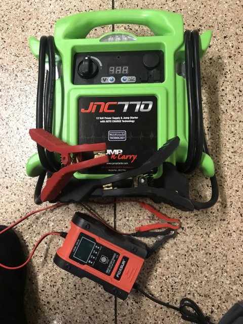

I have the old (going on 4years) Arc Angel. I found that while it was spinning the motor on startup, it wouldn’t fire. That turned out to be the EFI coil packs. They require a minimum of 11 volts or they won’t fire. If the battery didn’t have a full fresh charge, then turning it over was dragging the battery down below that threshold. Those coils are outta here so that issue won’t be a problem any longer. I have a self contained jump starter that is for use at the track. Hooked that up and it fired immediately. So no issues with jumping (so far 🫣). I also have one of the NHRA battery disconnects that help when the car sits. BEE8DC85-023E-4D21-B312-165071EC6AF3.jpeg

You can jump a lithium battery with a jump box or cables via another car no problem. Have done that several times at the track without issue.
