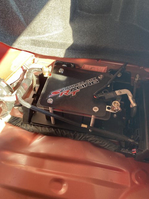

I have a Darrel Cox lithium battery that I purchased last August and yesterday it was dead, showing 6.3 volts! Wouldn’t even open the trunk. I panicked because it’s opening day at my local track today, anyway my 4 amp battery tender didn’t like the low voltage and would not charge it so I put the 6 amp charger Darrel Cox send with the battery on and it worked, it brought the voltage back up to around 12 volts and then shut off, so I switched back to the 4 amp battery tender and this time it worked, it charged the battery to about 14.6 volts and then shut off, took about two hours. Anyway everything seems good, showing 14.2 volts while driving. With a lead acid battery usually if the voltage drops below 12 it’s trash, not the case with a lithium battery.

Well, got a text from Nick at Arch Angel Batteries and he told me that the new battery had shipped out to me a about a week ago and that I should have it any day and it arrived a few days ago. It looks nice. Very similar to the original battery that he sold me 3 years ago. The new battery has a digital volt meter on it which is cool. It tells you the amount of volts and the percent of charge on the battery. Battery came 99% charged when delivered. Another interesting side note was that the new battery feels lighter so I weighed the old battery and the new one for comparison and I was right. The old battery weighed 18.6 pounds and the new one weighed 15.0 pounds. Also, the old battery felt much heavier toward the positive side of the battery but the new battery feels perfectly balanced. Weird! Put the new battery in the car and it turns over fast and starts with relative easy as most people would imagine. The volt meter in the car was reading 14.3 so all is well. Been raining here so I haven’t had a chance to take the car out but I think she’s ready for Brian Mason’s private track day on Jan 7th. Praying for mineshaft air and killer negative DA with low humidity. See pics of the battery attached.
I found out they don't like cold. Last year my car sat for over a week because of snow and it killed the battery. Once I got the car in storage I took it out. It only drops a little from 13.2 sitting in the house over 3 months. Sitting at 13.2 right now, took it out of the car 11-5

Yes it was shorter. In my thread I used a piece of aluminum to bolt it down. Weighs 14.6 lbs. I also could not find it on amazon but I linked the battery from a different place above
