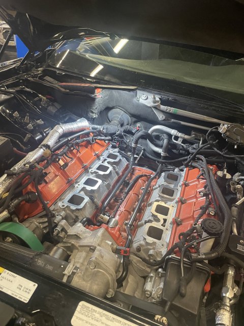

Lfrx7’s are in. Car idles so much better… wonder why…
Out with the old…

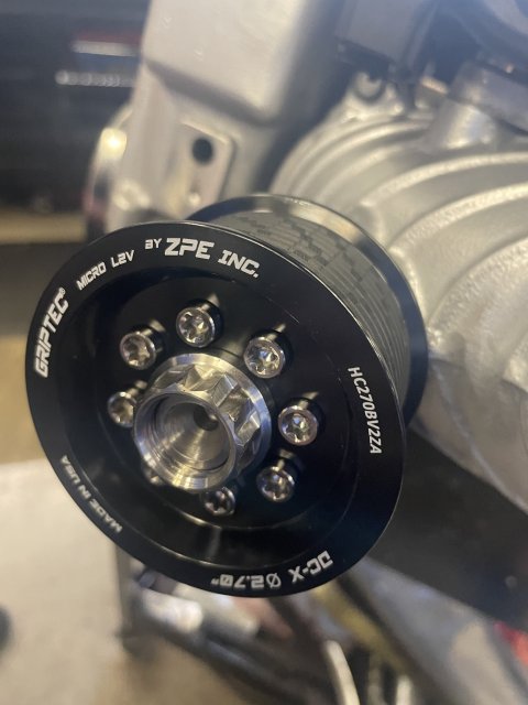

griptec makes a solid product

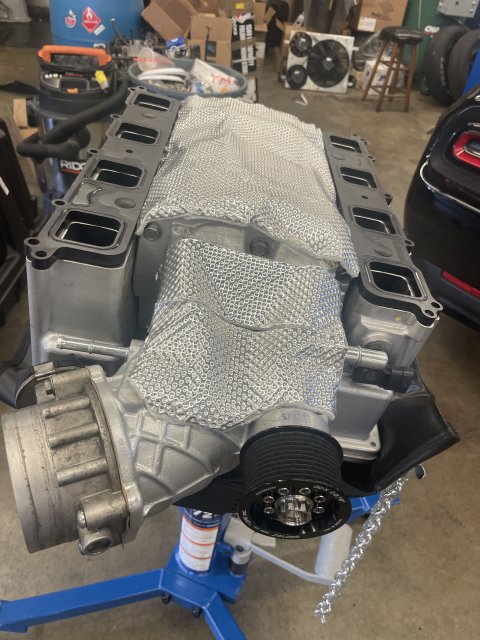

put back on my spacer plates and put a new heat blanket on
mike found an oring that needed fixing, he recommends lithium grease as I told him I used oil, he says oil can make them expand in a bad way

in that quick little WOT. Was only .59 lean. Going from a 2.72 to a 2.70 requires marginal changes! Now I just need @jonx96 to sell me a 2.6x, lets go!

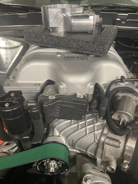

The TB is physically attached. I did a throttle re-learn from VCM scanner. If anyone is running a 108mm throttle body from Kong, can the disclaimer on their site with “No tuning” required be correct or is that for stock applications only?

I have 0 experience with one but a 108 seems fairly big for no tune required. Just my thoughts I could be wrong. I'd think if you tuned for it there would be more gain than not tuning for it.
7,531
19,768
Maybe. It's air flow right? So since these cars are wideband all the time the fueling can likely adjust for the TB. You have 10%+/- of fueling adjustment that won't be any problem, more than that I'd want to adjust it. Won't throw a code until +/- 30% though if memory serves.
If the car doesn't have a freak out at idle then maybe it is plug and play. Personally I'd wanna dial the fueling in though just because.
Historically if the TB was a problem for the tune you'd get some surging and up/down rev all on its own at idle.
Looks awesome Fuman !
I think you would want to fine tune it with all the changes that you made.
One tid bit that I noticed that I think you should insulate the coolant tank next to your air filter. That tank gets perty hot & puts off a lot of heat.
