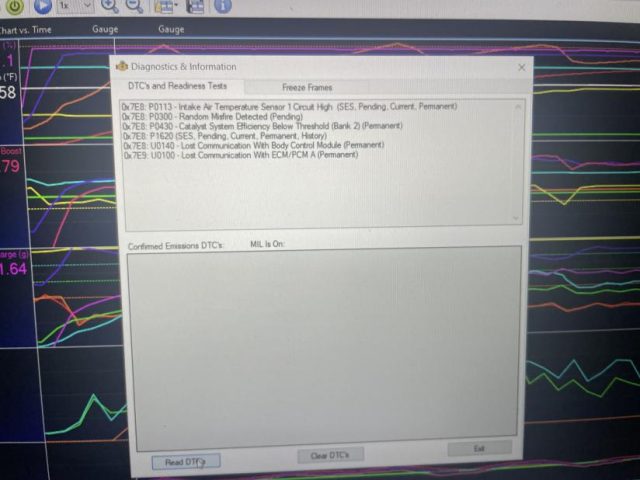

14* of timing, need to add some fuel, seeing about 20* of boost max. This was off idle.

Your issue is mechanical, not tune related. Swap out the bypass valve with a fresh one and hope it performs better.

I don't think it's related, but I do see your INJ PW increase above 6300rpm and fuel pressure begins decreasing at the same time going from about 80psi down to about 71psi. It's not causing the bypass to open that I can see, but that's something to keep an eye on as you're taxing the fuel system. I'd add the pid "desired fuel pressure" so you can compare commanded to actual. Mine is always 80psi for both and fuel pump duty % never goes over 85%.
