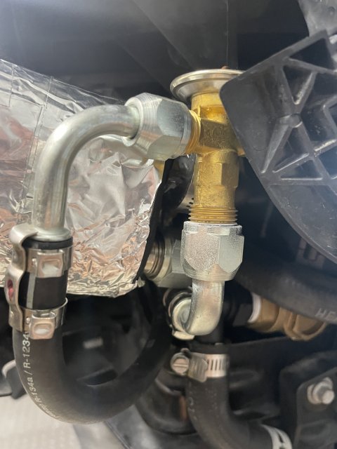

Killer chiller just said fuck you…

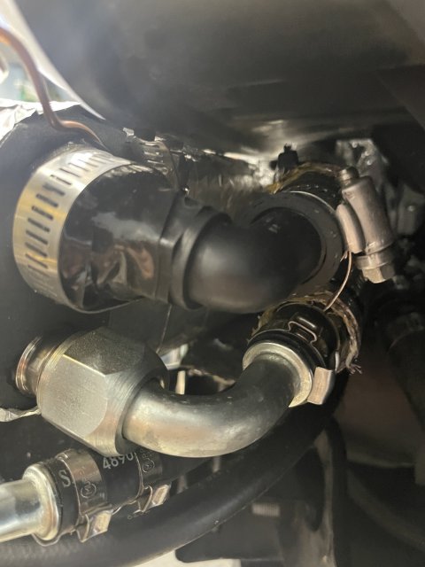

38817D6B-26A6-4977-BAC7-325292AF8013.jpeg 746E5940-C7A8-4273-96E2-D9D55DE548A4.jpeg

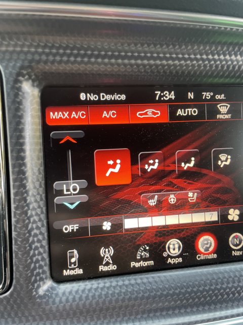

coolant flows, all valves open or close when commanded, ac blows ice cold when doing cabin…

The unit is not getting cold, however the AC blows stupid cold.
3,687
8,695

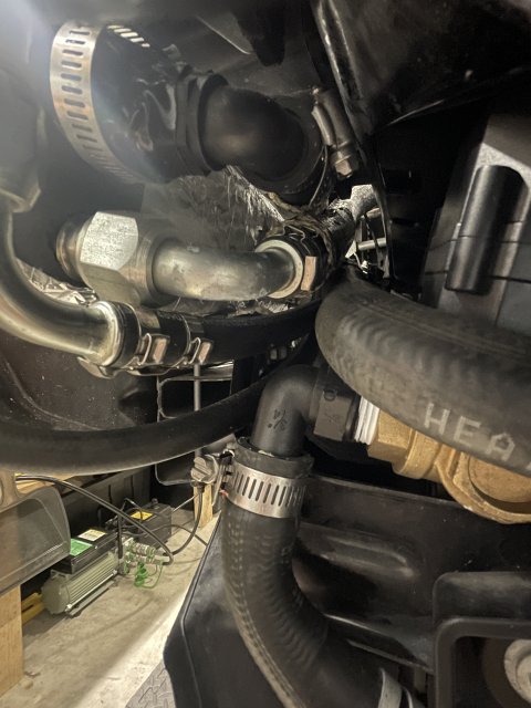

How is the orientation of the unit? Can you post a picture of the Freon in and out lines orientation to the ground? The outlet needs to be on the bottom not the top or it can fill with liquid Freon and not evaporate correctly, worst case not even flow, ie not get cold then.
Thread Starter #830
It is oriented down as per Kincaids instructions.

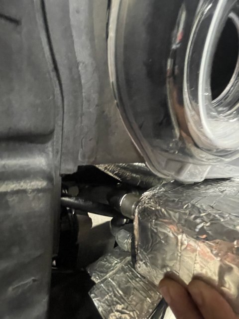

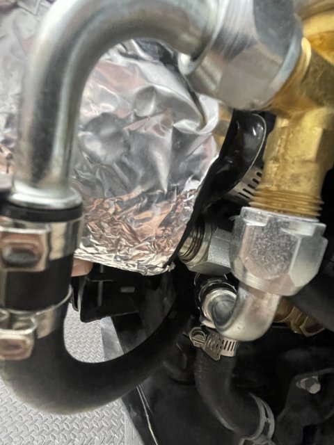

33E1D273-8218-4242-9A1D-CC69F95470D7.jpeg D9F32D88-42E8-4C6D-86A7-4B22CF095666.jpeg B5B2A86F-EF4F-4610-953B-F4AC6AA31313.jpeg
3,687
8,695
Yea, looks right from pictures posted. Does the pipe and hose on the bottom of the TXV valve get cold during operation?
Thread Starter #832
bottom line coming from ac compressor with drag valve closed is cold
only thing I can think of is serious airbubble in the lines or the unit is bad. :(
The only moving part in it is the TXV valve the brass colored device. Out of the bottom of it going to the heat exchanger itself should get ice cold. If it’s not it’s not letting liquid Freon go through it or there no liquid Freon there. Did you check the charge pressures?
Is the intercooler coolant circulating for sure through the KC unit?

I dont have ac tools so no way to check, should I whack the brass with a wrench?

What did you recharge with 134A or the original 1234 stuff?
Thread Starter #836
Original

You have a cheap R134A charge can with gauge? If not go get one and just use the gauge and hose to see what the suction side pressure is. If may just be out of gas as it’s hard to get the system to be 100% leak free.
Thread Starter #838
how? Cabin ac blows ice cold when KC drag valve is not operating

Spoke with Joe from Kincaid, great guy. Wants me to make sure there are no leaks. Do a check at ambient and do a check with the car hot. The coolant in the bmr tank is being removed, going with a 30/70 mix. See if I can get it colder. 15” brake conversion as well Thursday night, should I not like how the car performs after that I’ll be posting it up as for sale on FB marketplace. I no longer have the stomach for this.
