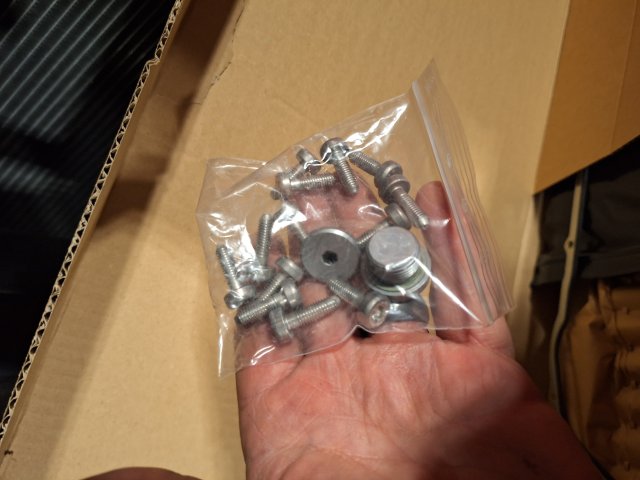

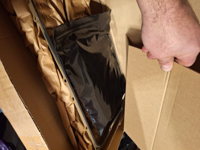

There's your A8 trans service package for Hellcat 8HP90's - includes BOTH plugs, pan bolts, new gasket and fresh filter.
I haven't searched for a while so I do not know if that part number has been superseded. Looking into that now.
