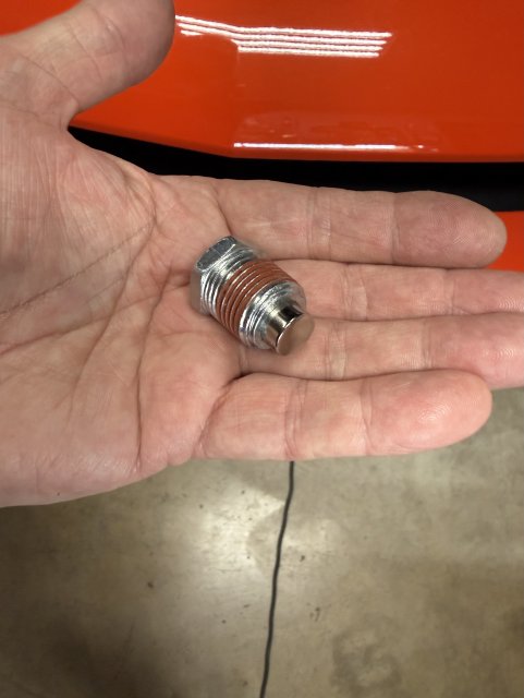

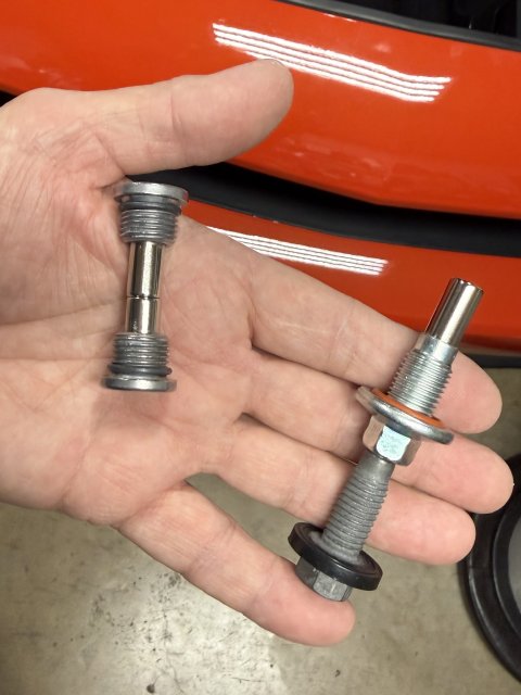

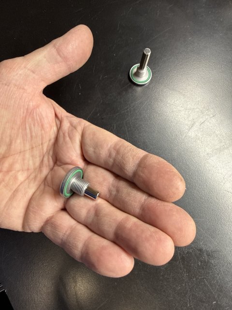

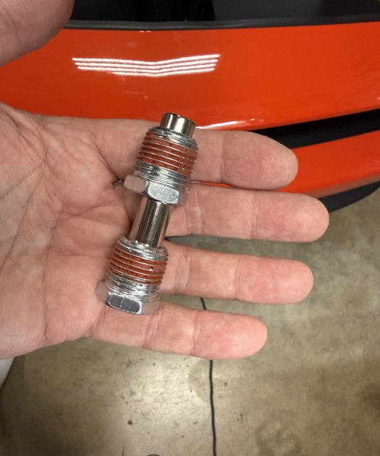

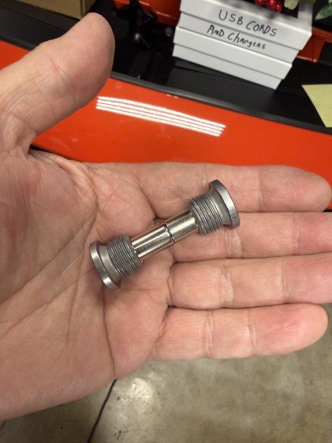

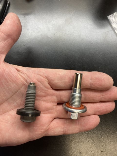

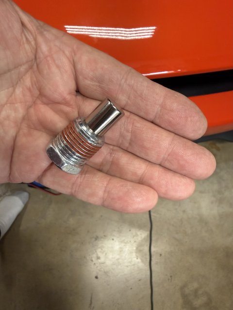

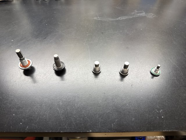

If you’re looking for magnetic drain plugs I make the strongest and most say the best out there. They’re a bit expensive but they work. For Hellcat, Redeye, Demon, etc and many other brands Ford, Toyota, Nissan, etc.
A8 Set below, left to right Engine drain plug, Oil Cooler drain plug, Diff Drain, Diff Fill, A8 drain plug.
Oil Cooler and Engine
Diff Fill and Drain
A8 Drain plug
M6 TR6060 Fill and Drain
Message me if interested

THANK YOU @BULL !!
Diff Fill and Drain
A8 Drain plug
View attachment 178099 View attachment 178100 View attachment 178098

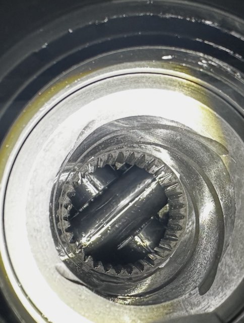

Definitely get one for the diff, I have some metal in mine.
