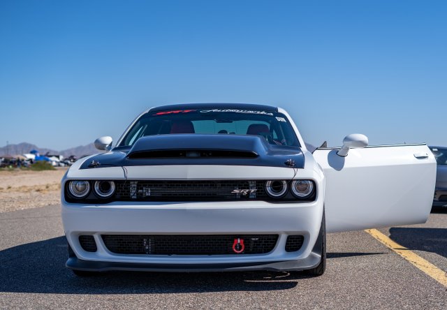

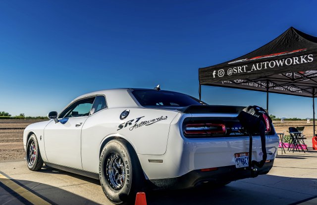

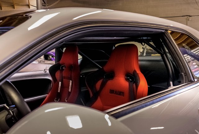

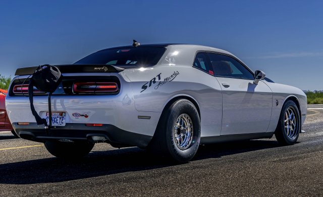

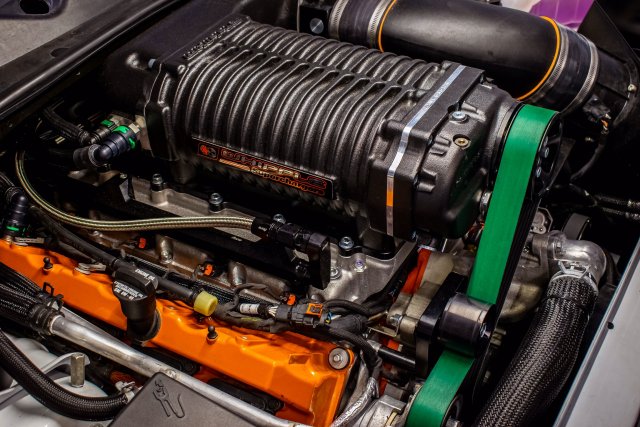

Ok Ok Ok. One more set. The pro pictures are coming in from the weekend and they’re too good not to share. From here on out we’ll keep it performance related. C9BDE660-1471-40AC-A0BA-9A2DAB151B92.jpeg 35499A6A-6D26-4195-BB97-A6F86E140B7D.jpeg 9701926D-1638-4484-826F-3BC5259D5B64.jpeg 2EAABCC5-B1DD-4F30-9E89-C40B8C4899FE.jpeg 9A5A1BB9-D159-4576-8402-3469BE163F29.jpeg
