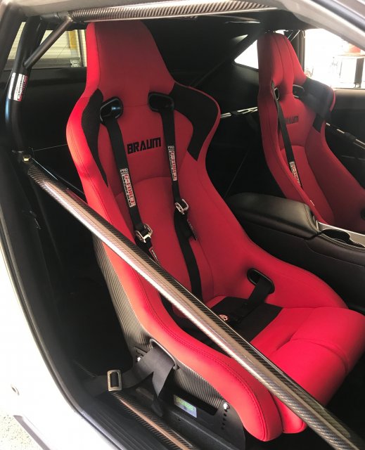

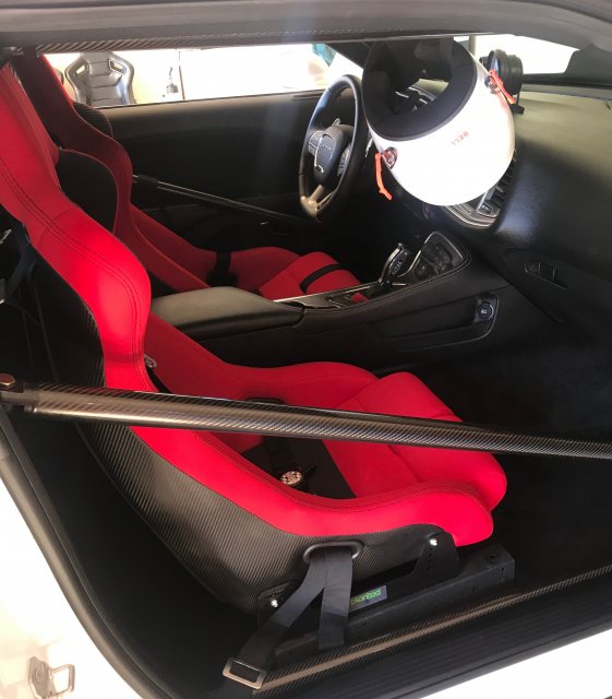

Some new interior shots for today. I love these seats! At 23 lbs each I can just leave both in for racing and not pay a weight penalty for being lazy IMG_9220.jpg IMG_9222.jpg IMG_9224.jpg IMG_9225.jpg

Looks sharp/clean. If you are going to keep your 8 speed for a while for giggles maybe leave it in drive for that 6200 rpm shift. You just never know.

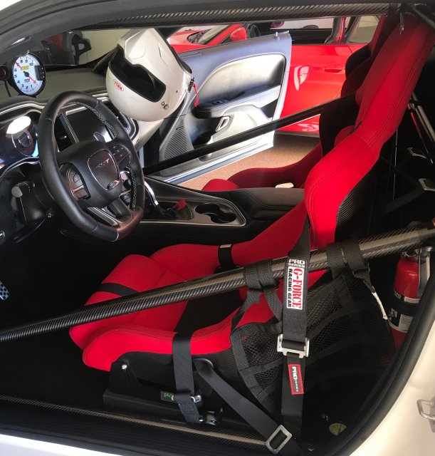

Ok Ok Ok. One more set. The pro pictures are coming in from the weekend and they’re too good not to share. From here on out we’ll keep it performance related. View attachment 4737 View attachment 4738 View attachment 4739 View attachment 4740 View attachment 4741
Hey Marc I hadn't payed attention I really love the Red Race seats. For some reason I thought I remembered they were black.
And your post about a TH400 is really the way to go. I hear the ATI's are good and known to work well in our Hemi's and with those that also distribute them. Although My husband preferred Rossler Trans for a race car and is what he was going to have installed in a race car he was once having built. Except it was a TH200.
Your HC is built strong and you will probably race a lot once it's dialed so I think the Th400 it is also a safer bet too!
In the prior to the Hellcats platform I was very much all about TH400's the nag1's were a Total POS once heading for the 8's
When are you going back to the track?
Linda :)
Linda :)
Thanks Linda. You didn’t remember wrong. The seats before were the black leather “street” version of these. They were adjustable. I changed to a one piece seat for safety at the more serious speeds. These are super comfortable and fit like a glove.
6,139
40,331
I can tell really really nice!
Yeah no adjustable allowed.
I had the seat from my husbands Drag Pak installed in my race car and I also have a Kirky race seat.
But those Red Race seats just cant be beat.....just aweome!
