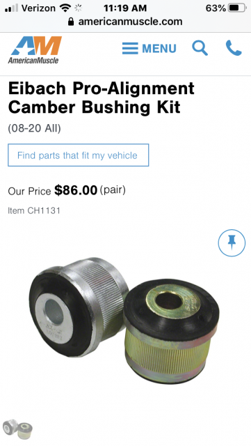

Correct . You get 2 bushing in the box . 1 goes on the aluminum upper control arm on the out side . The other bushing goes on the stamped steel upper control arm on the out side .
1 box does 1 side of the car .
Oh, my dumb ass was thinking it was just doing the aluminum arm, not both arms, thanks for clarification.
You have to do both arms the same amount on each side .
OK, now what about toe adj., is the stock toe arm adjustable or does that need other bushings too ?... to get 0 toe.
The toe is the only thing adjustable back there from the factory . I had no problem adjusting my stock toe links to 0 .
OK, thank goodness for that, lol.
Thanks to @Speedy! for the thread, you have a lot of info on this now so hope it helps you as much as it did me, & Thanks to @Hpindy, @moparjim, @Marc W, @16GoManGoHC2, @DGatzby & @oilburner for all the info & help.
I think I will try the moog bushings for a compromise for the camber settings & no NVH.
Now I need to You tube - how to replace bushings.
YES!! please post how it’s done I’m curious and for 160$ may rebuild my stock removed ones and see how they work, I just love experimenting lol
These are Stainless, look like the better of the 3 posted?
OK, now what about toe adj., does the stock toe arm adjustable or does that need other bushings too ?
The stock toe arm is adjustable but like EVERYTHING in the Hellcat it’s connected with big fat sloppy jelly donuts for bushings. Wobble wobble. 😂
I put polyurethane bushings in my stock toe links .
Thanks, I'll let yall know how it goes when I get to it, it didn't look to bad on the You Tube vid. I just watched but you know how that goes.
I noticed that the moog ones are life time warranty, wonder if the rubber is any different from one to another on these ?
What's even better is no matter who you buy them from it has "SPC" stamped on it . Lol
OK, whats that mean ?
Hpindy
#974
4,875
11,025
Jackson's Point
2018 challenger hellcat
They are all made by the same manufacturer ( moog) and sold by different resellers .
