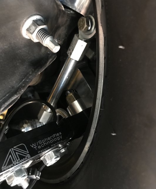

It looks like NJ_redeye has substantial interference with his AAD install and using the HHP shortened stock end links.
If you do anything that requires taking the wheels off in the near future...make sure you inspect the arm and bar closely for contact. It will be very noticeable.
I had theorized the HHP and Bwoody should be the same length in my other thread. We found stock to be roughly 10.25" and the StolenLogix billet links to be 8.25".
Reported interference so far on:
HHP shortened factory links
You currently have the Bwoody which I've also ordered to collect data/feedback.
Interesting to note is AAD hasnt seen a widespread issue with shorter links causing interference and also that Bwoody never did reply to an inquiry regarding the length of their links and a description of what we are seeing.

I have my wheels off now changing axles, can’t see anything that rubbed but I will keep my eyes peeled for such. THANKS for the info!!

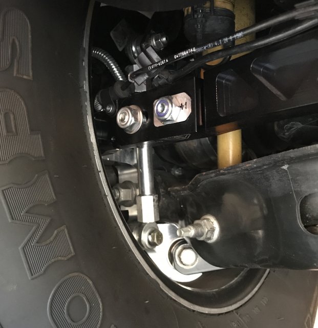

I have HHP shortened end links. I'll have to get with Parker at AAD and see what's up.
You can get adjustable end links. Mine are Carlyle. I have their 15” conversion with the billet spindle that requires a really short link. I haven’t measured it but it is REALLY short. Adjusted to fit, it doesn’t hit my AAD arm. 76CEEAEC-18CC-4558-BBE7-EDC98CD9F4A5.jpeg 7D6EF3DC-2FC9-4A96-A7D9-792659013A46.jpeg
Usually its seen on 15" kits and arent aware of it happening with a typical shortened link on a 17" package...according to Zach anyways:
"To touch on the sway bars hitting our arms with shorter endlinks. I have seen it 2 times, They were both on 15 inch cars with very short sway bar endlinks. If you purchase shorter sway bar endlinks with 17s it should clear no problem!!!"
That's just not what we are seeing lately though...so there must be multiple contributing factors that we are missing. There's definitely something happening though.
