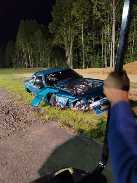

Video of the crash from last night. I was in the lanes right behind the guys. It was nutty. Having a cage was on my mind if I ever went 9s, now it will be mandatory after watching the carnage from last night.
Pics from a friend.
Was the guy ok ?...What happen ?....did it blow & got in his own oil ?... doesn't surprise me that it's a mustang.
4,104
10,283
Thread Starter #191
His wheels were up I think for the length of the run and when it came down, veered to the right.
Oooops,,,, dead stang. Legs up. 5.0 gone.

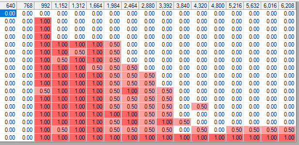

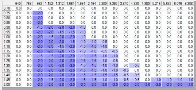

Well more importantly hope the puppers is okay, seems like a very cute snuggle buddy compared to my 120lb bed hog. I can review all the footage as it is a 360 camera and see if any black puffs come out in the runs (technology is fun). These runs are from Friday night when the timing was wonky, I think you have seen logs one and two, I am attaching all of them in this thread to keep things sort of neat. Only shit on the other thread cause I was frustrated to hell at the track and Wi-Fi was spotty.
So in the tune from runs 1 & 2 the spark table was modified and timing was added, in HP Tuners it had this as a difference (lets call this R8):
In run 3 I reverted back to the previous revision (R7) which didn't have the added timing above. Then on run 4 I added a small bit of timing back in, about 50% to R8:
