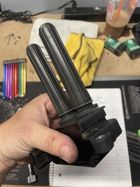

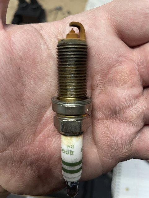

Kinda pissed, found previous owner ran boostane. Im in here and making it right. Gapping to 0.028 and she might be happier.
197B43B9-AA35-42C6-B0A8-A731BBB336C5.jpeg 1063942C-A55C-41EC-8C73-DE697BD26920.jpeg D84E8124-0C82-4094-B3D0-B324DADB3AD3.jpeg D6DF9BE0-8635-445C-8E32-B769610938DF.jpeg 1F7D06AA-1724-4AB9-842A-764201A46447.jpeg 33CD4B01-EB28-4D03-928B-217BBDB9CC9F.jpeg
I have only ever run 93 and 104 in the car. Cylinder 1 done. Seven more to go. 💪

Strangest anual probe I have seen cents I left Costa Rica in the 70s. her name was Ann U Ail. What a gap. Kinda dirty.
