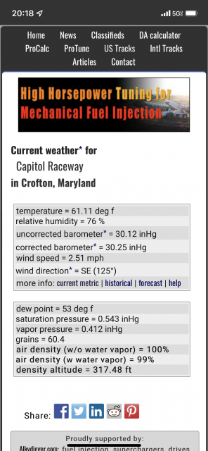

Finally collected all the data. Although DA went down, Humidity and grain size shot through the roof. It was really a fight against time.
Can't wait to have an interchiiler so even 130 IATS are not a thing.
Oh man, I can't wait for some DA like that, very good. The humidity was getting up there on last 2 passes, that's the bad thing about racing into the night vs during the day.

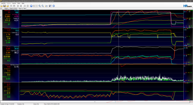

Looking at your data......
That last run would have been a 9 second pass in my car....probably a 9.95. For some reason you lost 2MPH at both the 1/8th and 1/4 points.
How did you determine knock was false? Did you make a pass on the Q16 with knock sensors left a lone and still see some knock? Sorry if I missed that.

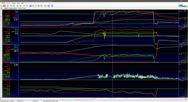

On the last pass I spun. Here is the log, see the dip in the speed.
So I spoke with some tuners, reviewed a lot of tuners "tunes" that they provided to me graciously and was told straight up: No mufflers, no resonators, solid motor mounts, a 2.72 pulley and a drive train that is solid, the body is going be sending signals to those knock sensors as soon as they find that right harmonic frequency which is just an artifact of the car. I also additionally had crap spark plugs in so it was a combination of things to test.
The Q16 was added to the 105 in a 1:5 gallon ratio (and it will not be run again, this was purley a safety measure). I ran the car down as comfortable as I felt, one notch below the 1/4 tank. Filled up with the gap sauce. The tune was revised to be conservative but still open up the knock sensors. They were multipied by 1.5 across all cylinders.

Those logs do look conservative for a Q16/104 race gas mix so that's good. I personally wouldn't multiply the knock sensors by 50% across the board, that's quite a bit. Not trying to tell you what to do with your car but I'd focus on the areas that actually showed false knock and adjust them by 10% until it went away on the Q16 with current timing advance then you know you're golden and can bring a bit more timing in on the good fuel. My 109 octane tune I used to run was about what yours is now but I had almost zero 93 in the tank when I dumped the race gas in there. I know some tuners do just use an across the board multiplier but it's a sloppy way to do it IMHO. The solid motor mounts and all that will be a factor for you but I'd still be as conservative as you can be with the sensors as they're the last line of defense for the motor.
