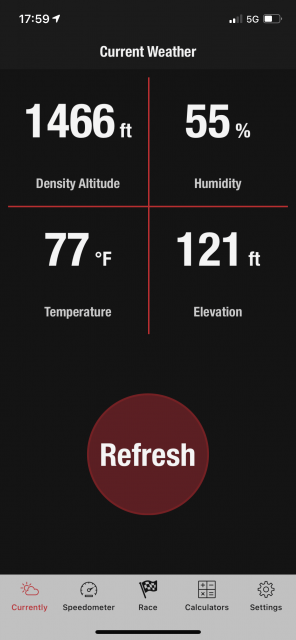

Nice vid, congrats on the 1.49, so your on the 305 now & what was DA ?
I went to HRP friday night with 2000 > 1500 DA, I had 3 - 1.47's & a 1.46 60'.
The track was kickin.

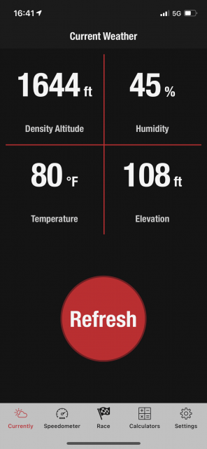

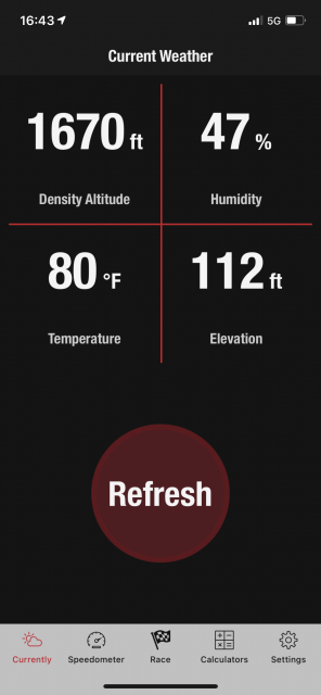

DA wasnt bad at all, however thats relative.
