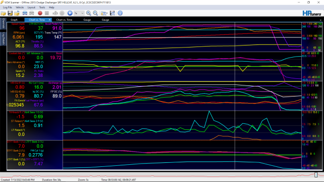

I haven’t looked at the logs but idling at 50 injector percent duty cycle is not normal at all
4,129
10,387
Thread Starter #902
Thats pump duty cycle my bad, not inj duty cycle.
7,531
19,766
My fuel pump DC is 45-47% on E85 at idle so I'd say that's fine. At WOT mine's around 80-82% in good air.

You're actually not dropping that much fuel pressure but you also don't have a lot of injector head room to cover for it. Even if it maintains 80+ psi, you'd probably run out of injector in negative DA as it stands.
With that said, I would add a single bap plugged into the slave fpdm. That'll fix your fuel pressure issue for the time being. You might have to add a 2nd one when the air gets cold if you stick to this configuration. You can also target higher fuel pressure during WOT operation but that'll just cause the fuel pressure to drop faster once pump flow is mechanically maxed out.
Your bypass valve is also on the verge of triggering a limp mode condition. This is typical whenever pushing over 21 psi of boost. As you mentioned, it is just an srt4 throttle body after all, not really designed for this use case. There are companies out there that sell modified bypass valves with a stronger motor. Either lower boost or upgrade your bypass if you want to avoid future frustrations. You could also take a chance that another bypass might be a little stronger but it could also be weaker. I don't recommend that route for you given where you're at with this car.
Your 1-2 2-3 short shift issue, that's weird. It's not skipping 2nd gear though, it can't physically do that, but it's triggering the 2-3 shift right after completing the 1-2. As to why, I couldn't tell ya. It's not something I've seen before which would be kind of odd don't you think?

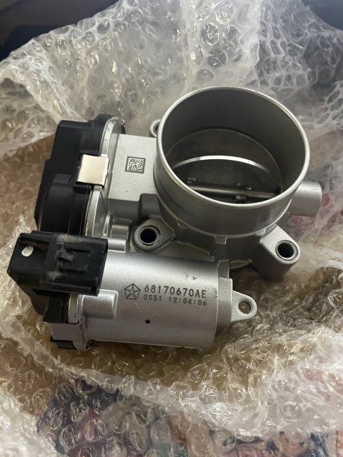

@zhc some good information here. I already ordered some bypass valves and this one came in today.

Gearhead Fabrications sells one called Badass Bypass valve.

You mentioned people make stronger motor versions, do you have a vendor in mind? I did searches and can’t find anyone.
You can order off of Gearhead Fabrication's website or give Baily's Hyperformance a call and get one done through them. You'll probably have to send one in as a core as cores are hard to come by now days. The stronger motors used for them have also been in short supply so expect a long wait time potentially for one to get returned to you they're on back order.
