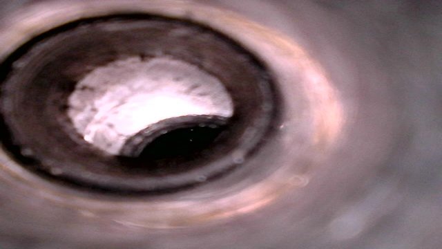

I've used water wetter in the past and it seemed to leave some silt like residue in the cooling system. I'd go for water mix. Just dont forget and let it freeze in winter. That happened to more than one.

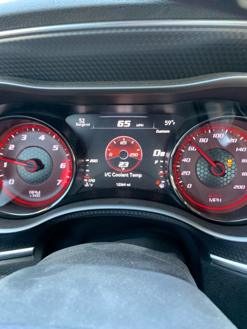

With a chiller, I wouldn’t run water without some sort of coolant mixed in to lower the freeze point.
Here’s why and also note that temps measured at the ICT sensor will be warmer than in the chiller itself.

Ah, excellent call, I forgot all about that chiller! Some math for mixtures and freeze points will be needed to find the minimum anti-freeze to water ratio for the temps you see, and I'd obviously error on the conservative side.

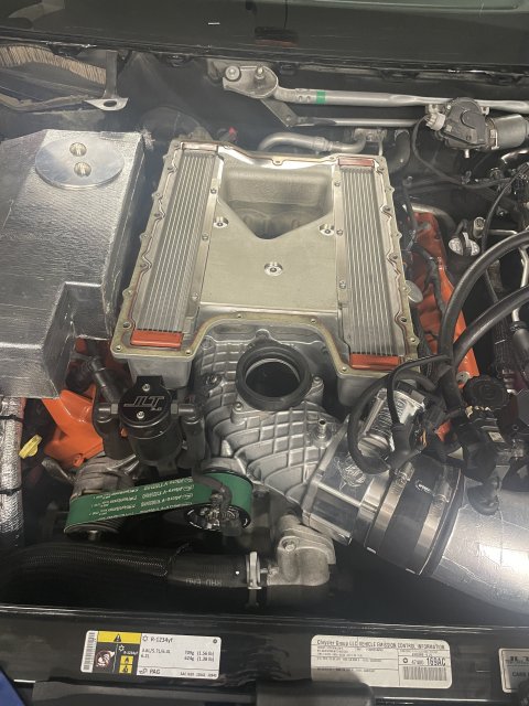

Put on the badass bypass valve.
However now I cant get the supercharger to line up.
im about to roll it out the garage and pour gas on it and be done with this shit. Why does it fight me on everything.

Lid or main bolts? If the main ones then it would help to take off the belt.
Thread Starter #939
Yeah thats what I had to do in the end, came back here and saw your post. Thank you… Im such an idiot sometimes. I think this car has just drained/fatigued me this season and Im worn out. Keep spending money but to don’t go faster. The pure definition of insanity.
